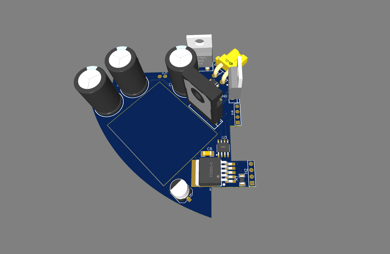

    • PCB design emphasizes two‑layer boards with standard 1.6 mm thickness and 1 oz copper, minimizing fabrication costs at budget manufacturers like JLCPCB

  1. Energy Storage & Boost Conversion
    • Input Stage: A 12 V DC supply (from robot battery or regulated adapter) feeds a synchronous boost converter based on the XL6019E1, capable of delivering up to 5 A at 48 V. Input filtering (220 µF, 75 V electrolytic + 0.1 µF ceramic) mitigates switching noise and protects upstream regulators.
    • Capacitor Bank: Four 100 µF, 63 V low‑ESR capacitors in parallel store energy. Their combined capacitance of 400 µF yields an energy capacity of ~46 J at 48 V. Layout emphasizes short, wide traces (<5 mm length) and heavy copper pour to handle high ripple currents.
    • Charge Control: The microcontroller regulates the boost converter’s enable pin via PWM, closing a feedback loop that holds the capacitor bank at a user‑defined target voltage. Charging halts automatically upon reaching that voltage or upon detecting an overcurrent fault.

Visualization and Component Placement
The project’s documentation includes placeholders for schematic and PCB images, making it easier for users to visualize the design. These diagrams will illustrate component placement, wiring paths, and integration points, providing a clear reference for assembly and troubleshooting. Including visual aids ensures that even novice users can confidently work with the circuit.
